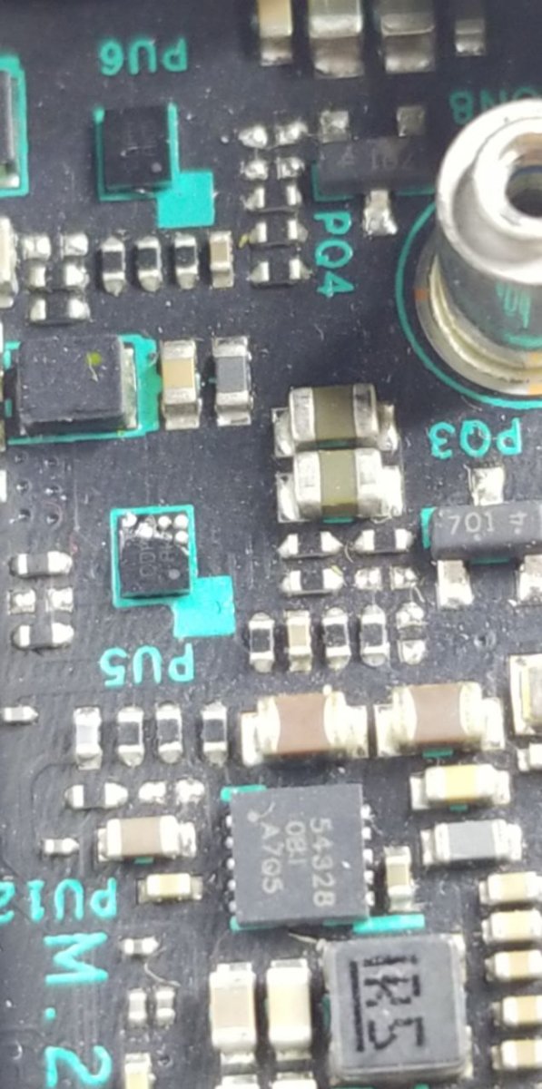

Hi all.
Tinker Board 2S do not boot. In the UART console log I saw:
PMIC:  RK808
rk8xx_write: write reg 0x4f failed, ret=-121
virq_add_chip: Set mask register 0x4f failed, ret=-121
rk8xx_read: read reg 0x2f failed, ret=-121
vdd_center -121 uV
rk8xx_write: write reg 0x23 failed, ret=-121
vdd_cpu_l 900000 uV
rk8xx_read: read reg 0x23 failed, ret=-121
rk8xx_write: write reg 0x90 failed, ret=-121
rk8xx_write: write reg 0x24 failed, ret=-121
rk8xx_read: read reg 0x24 failed, ret=-121
vdd_log 1100000 uV
rk8xx_read: read reg 0x49 failed, ret=-121
-121 uV is too high from LDO_REG8

RK808 is dead?
Share this post
Link to post
Share on other sites
hello @dellfer,
there's something wrong with pmic from the log, usually the boot process will set parameters for:
vdd_center 900000 uV
vdd_cpu_l 900000 uV
vdd_log 1100000 uV
it might be caused by the uboot defconfig & kernel dts changes. have these been modified? if so, what are the modifications?
