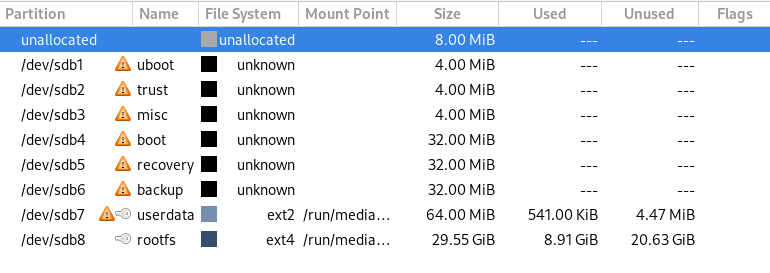

wahaha 4 Posted June 25, 2024 (edited) Hi @tooz, I've successfully ran ./make.sh tinker_board_2 CROSS_COMPILE=/path/to/rockchip-linux-prebuilts-gcc-arm-10.3-2021.07-x86_64-aarch64-none-linux-gnu/bin/aarch64-none-linux-gnu- I noticed that in the make.sh file, it says -> board built okay, there are uboot/trust/loader images in current directory. From this below image, I understand that uboot and trust image can be written into the sd card via the sudo dd command. Curious, what do I need the loader that was created also? I also understand that boot is the kernel. But what about misc, recovery, backup? How do they get generated? Edited June 25, 2024 by wahaha Share this post Link to post Share on other sites
