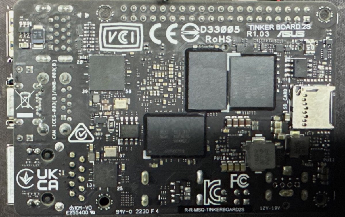

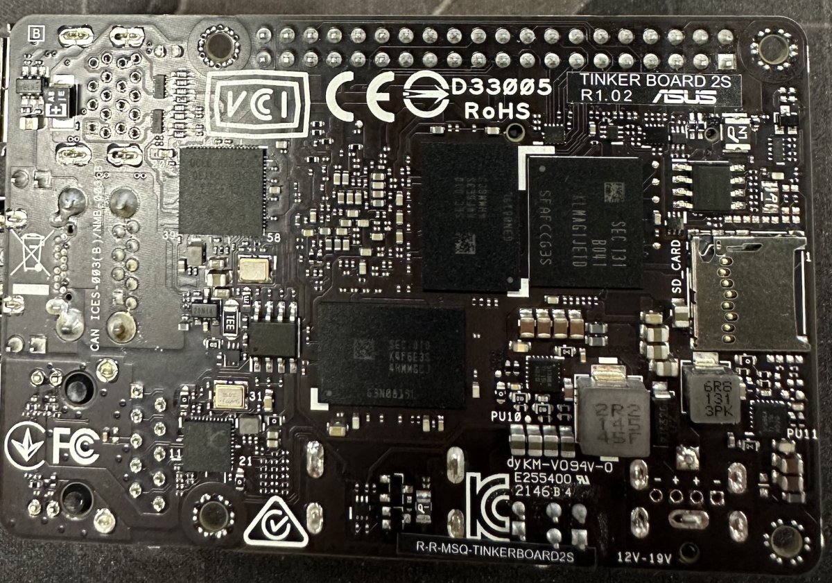

Only thing we found is that new boards are TinkerBoard 2S R1.03, but the master image was created on TinkerBoard 2S R1.02.
@tooz Is there a way to make the image work on all hardware revisions?
Please check the photos below for revision info:

btw, /proc/boardinfo content on both boards is:
Tinker Board 2S - 16GB
however, /proc/boardid on "master" board is "1", but on new board is "3".
Just to mention, restoring "master" image to TInkerBoard R1.02 still works properly.
